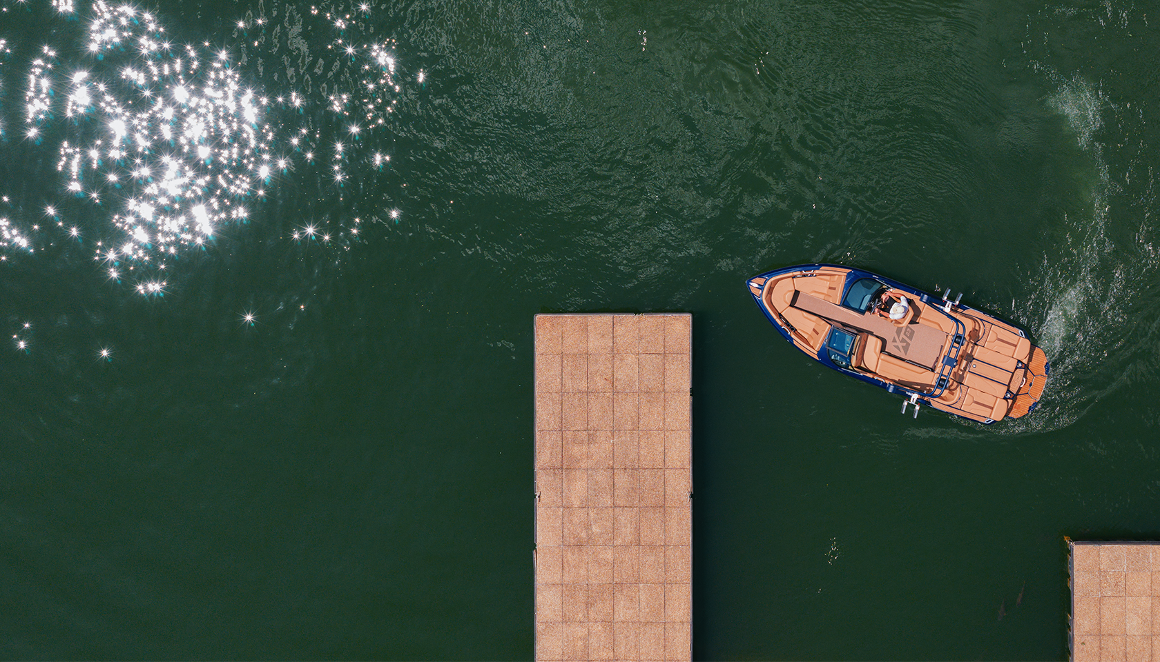

Approach the Dock Slowly
When you’re coming in to dock, it’s always better to approach slowly rather than too fast. Keep your arm planted on the armrest, making small adjustments with your hand and wrist instead of large movements with your entire arm. This allows for more control over the throttle and speed, giving you greater precision as you move toward the dock.
STEP 3
Aligning the Boat
When you're getting close to the dock, it's ideal to angle the boat slightly to the right. This is because when you put the boat in reverse, the boat will naturally back to the right, which helps straighten the boat out. Once the boat is parallel to the dock, you can tap the throttle in and out of gear—forward or reverse—as needed to position the boat exactly where you want it.
