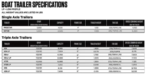

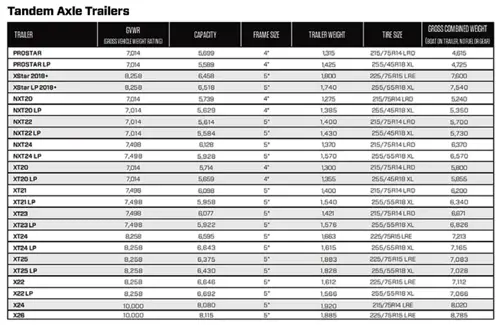

What vehicle should I select for towing my MasterCraft?
Continue Reading
When selecting a tow vehicle for your MasterCraft, it is important to determine the exact weight of your boat and trailer. These weights must be confirmed before you can choose a tow vehicle that's right for you and your towing needs.
MasterCraft has provided the "BOAT TRAILER SPECIFICATIONS" matrix that will help you to look-up and understand your MasterCraft's boat and trailer weight ratings. This matrix is available within the current Owner's Manual on pages 429-430 and is shown below:
Boat Trailer Specifications
Tandem Axle Trailers
