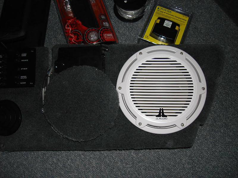

There is indeed a space provided in the drivers kick panel for the sub. Sorry I do not have any photo's but if you put your hand on the upper portion of the kick panel, to the right of where the fuse panel and/or PerfectPass module are typically mounted, you will feel where the carpeting has no backing panel behind it. In order to mount your sub, simply remove the panel, which is held on by 6 screws I believe and you will see on the backside where the hole is, leaving you to only have to cut the carpeting to drop in your sub.
Hope this helps.
