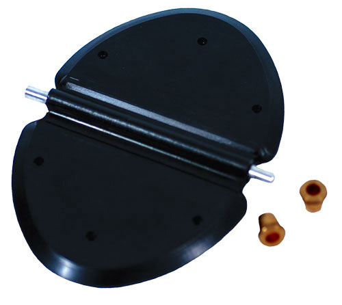

or could I use these?
http://www.hardin-marine.com/p-12576...t-flapper.aspx

yeah my whole assembly blew out and have a week at the lake coming up!
Ordered some regular flaps from skidim and will see if that works. The internal flap would be better as All I would have to do is drill two holes in each tip.

No not really, boat was louder one afternoon and sure enough the whole piece is gone! By searching the forum this happens to all the 07 boats with these tips.
Looks to me like those internal flaps would just need two holes drilled and those little brass pieces must get crimped together...........but I dont know for sure.
Thats why Im thinking of cutting them off flush and installing the external flaps. Looking at the 08 tips I would think they could be cut down and use the MC logo flappers by taping some new holes in the flange itself.
I really dont care how they look as I dont want water in my engine.
