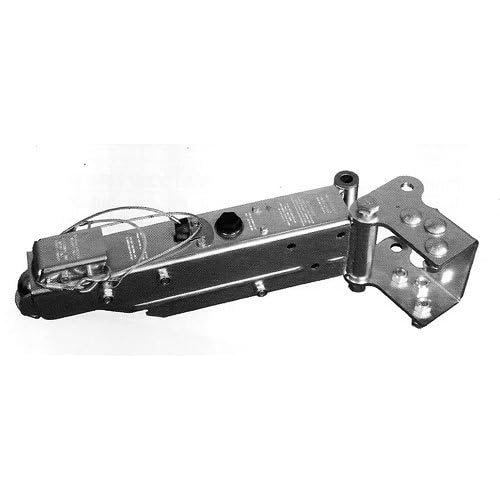

Decided it was time to dig into this thing. Calipers are Reliable CR-1000. Hopefully Kodiak can cross reference them for me. Got under and looked at the actuator damper. Here's the pic of the actuator for good measure.
Here's a Titan 7500
I read on here that MC welds the wings on to make it's own swing/hing. That seems correct and, of course, the top plate is welded right were it would read "Titan" if, in fact, it's a Titan. I did locate a Titan Aero 7500 PDF on the Net. Looks exactly the same and the damper, the part I want to replace, appears identical (part# 4502000). Actually from reading in an old post I found, and looking at another PDF, mine is actually the discontinued 6000 model. The glaring difference is mine has pins and the 7500 has bolts (nuts visible in the above image).

That does't look stock. At least not anything I've seen before. All the actuators I've seen are painted. I'm sure I could be wrong but this looks to be added by someone.

That's a stocker, circa 2004. Others on here with the same setup. In fact, here's a shot from the 2004 owner's manual showing part of the MC-made swing hinge. Exact same as mine (just the wrong color).
