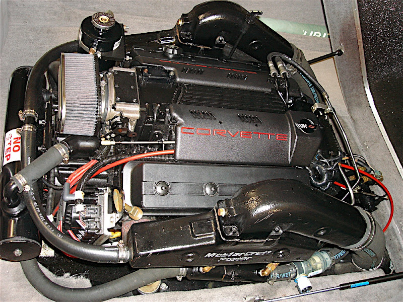

I had one on my '96 LT-1.
If you are rebuilding a motor, installing a CC system will be EASY! Orca is the big manufacturer and their systems are usually around $1,000....

I did quite a bit of research recently on a closed cooling system for my 96 prostar 190. Orca is definately the bomb but it's also up to $1700 for the GM motor set up. Ouch!
Hey Sodar, Thanks. For a diehard Prostar guy that is engine porn in it's purest form!!

That decal came with the system, you little b*t*h
