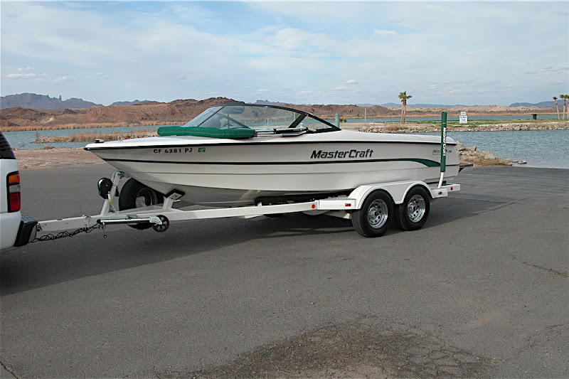

Thanks for the responses. Great pic of your boat and trailer SODAR. I Think I will defiantely be able to get it figured out. By the way TMC#1 , how did you get those fins polished out so nicely.
