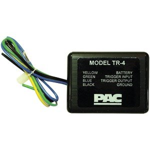

There are line outs for your amp, but unfortunately no "remote" line to turn on the amp. To solve that problem, I bought a $12 unit from PAC that will accomplish the task of turning the AMP off when the stereo is no longer in use: PAC TR-4 Car Audio Remote Wire Turn On Wire 2 Second Delay Module
