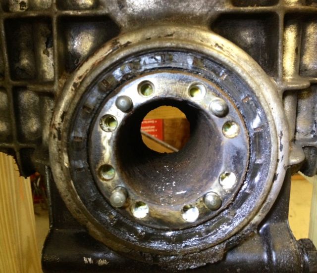

I have found the amount of rusted bolts I have had to deal with on this is a pain, but it is to be expected with an unmaintained saltwater boat. The trans flange gave me the most trouble with stripped out allen head bolts. They finally came out with 5 days of soaking in penetrating oil, heat, & EZ-outs.

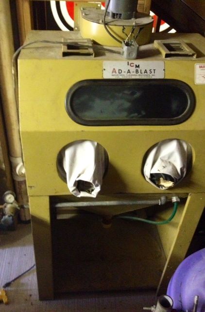

I finally picked up a blasting cabinet, as everything will be blasted & painted or powder coated before reassembly.
Which is better for a saltwater environment?
