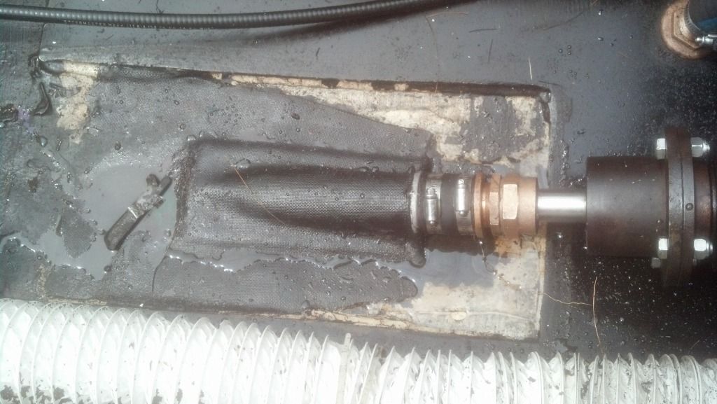

Then the real culprit, which was staring me in the face the whole time:
I knew this looked terrible but until I read a bunch of threads on the same issue assumed it was just coming from the shaft packing.. (which I also replaced this weekend).. More to come on that, hoping to get it all reglassed before the weekend.

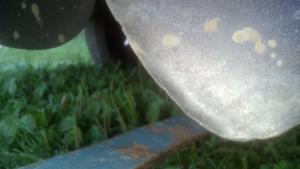

This vibration is what I'm most concerned about now and need to figure out (hopefully quick).. I checked the usual suspects and found no play in any direction at the prop end of the shaft, cutlass bearings likely need to be changed out due to age and sitting but I see and feel no play.. I also checked the prop from what I've read and did find one blade has some bends on the tip:
The only reason I'm tending to rule this out, is that this is what it's been since prior to my owning it. so why would it just show up?
