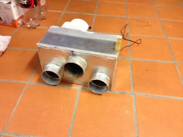

Heater box is done...apart from paint/powdercoating depending on what I decide.
Did a test with hot water out of the tap and with only one blower, its cranking out hot air probably as good as my 08 Navara does. Should be perfect with two fans!!!
Now to try and make the hot tubes for cheap
