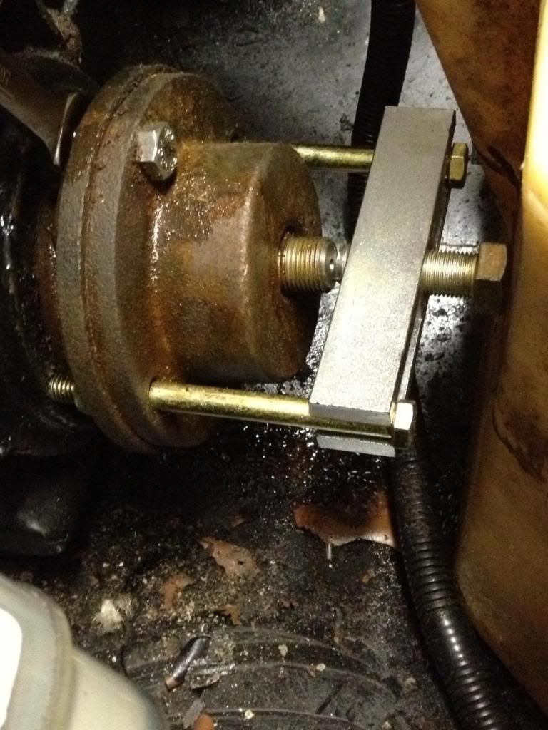

I'm trying to pull this apart before I order all of the parts. I just pulled the prop (great fun!), & now I’m about to disassemble the inner coupling. Before I mess anything up, is this the proper procedure? Can anyone give me a quick run-through of how it all comes apart? I have looked at the manual & nothing addresses this part of the removal.
Thanks again for everything,
Luke
[IMG][/IMG]
