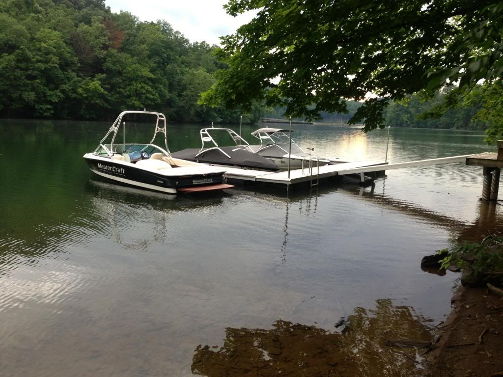

Had about an hour left of daylight and decided, lets get this baby wet. Lake is only 15 minutes away. What could go wrong?
Backed it in fired it up and the shifter linkage wasn't right... Screw it I want to drive it. Unhooked the linkage put Mrs Chief at the helm while I manually shifted it and we take it for a lap around the bay. What a major relief that was, I was so afraid I would have a bent or misaligned shaft, a bad prop or some drivetrain vibration to troubleshoot. That fear was put to rest quickly. I was impressed and relieved the boat drove as nicely as my Buddy's 197 TT I've been driving and skiing behind. It did get pretty interesting trying to dock it in the dark with the Mrs. at the wheel receiving throttle instructions from me (The Shifter).
Spent Saturday morning figuring out the transmission linkage and bolting in some of the interior pieces. Took it out for a shakedown run and it was flawless. Got back to the dock sent out some texts to find a driver and took a nice afternoon nap in it.
What a great feeling after 6 months work to get this boat in the water, get a wakeboard pull, and then give the guy who's been the catalyst for me getting back into waterskiing a pull behind my boat.
Sunday it was raining and a bit windy, but still 75 degrees. The running boat allure was too strong to keep us away, so we took a 10 mile trip up the lake. I had the wife drive and coached her on driving straight lines, avoiding swamping fishing boats and holding a speed since the perfect pass is inop right now. I hung the rope out and practiced a couple skier pickups and takeoffs. I then got the board on and had her give me a pull. The Mrs. did an excellent job her first time at the wheel of our boat. She was a farm girl and can operate a tractor so she is basically just recalling muscle memory right?
I still have alot of work, I could go all WV hillbilly and run it like it is, But I had to pull it out and bring it home so I can work on getting it cleaned up and ready to leave in the lake for the summer. She will be in good company this summer.
