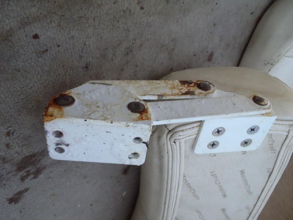

Drivers seat is frozen to the tracks by rust. I got under it and freed the latch mechanism but couldn't get it to slide. I was able to remove the bolster, so I can remove the bracket and clean it up.
Also removed the platform brackets to get them in line for a date with the paint stripper and blast cabinet.
Most of these brackets have pitting, I feel I can live with that and just cover it with a good protective coating of paint. Suggestions are always welcome, I was thinking epoxy. I don't really want to pay for powder or anodizing.
